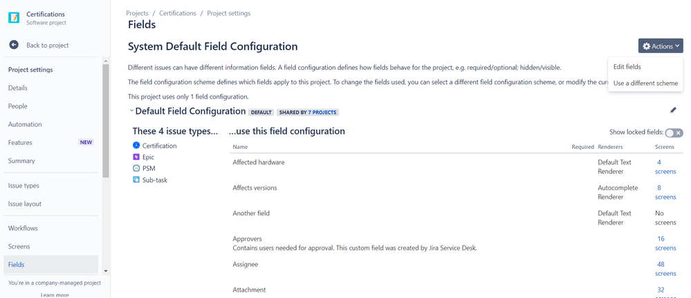

  • Go to project B
  • Go to project settings
  • Go to fields
  • On the upper right corner click actions > use a different scheme
  • Click your desirable field config scheme
Let me know if this is what you wanted to do.
Hadas Hamerovv
September 19, 2021
I thought so. I did it and indeed the subtask is associated with this new scheme.

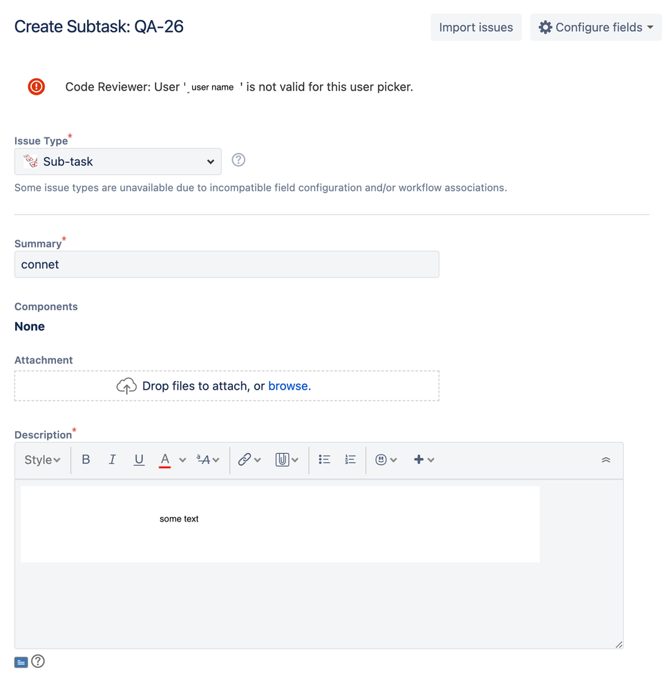

However still I cannot create a new subtask for some reason. Maybe the 'create screen' is still the one which is common to this project and project A?
Or...I actually don't know what the reason is but I receive this error message:
Code reviewer (A custom field I added to the other project) is set to a user which is not in this project (B)

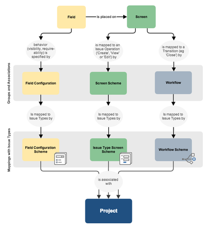

Here's a little diagram to help you understand better the relationship among the different configurations in Jira:
If you are interested in learning more, please read this: https://confluence.atlassian.com/adminjiraserver/project-screens-schemes-and-fields-938847220.html

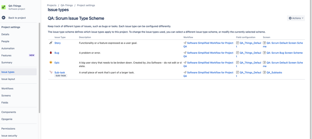

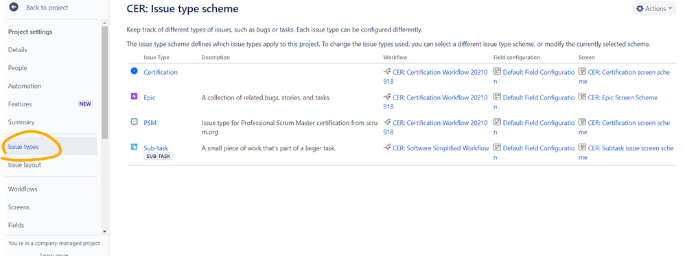

Give me a screenshot of your project's issue type general configuration. Go to project's settings,  issue types.

What I want from you is the following:
For example, on the above screen, my subtasks has the same field configuration as the rest of the issue types. If on this config a field is required then it will be required on the create screen of the subtasks issue type.
Hadas Hamerovv
September 19, 2021
Hadas Hamerovv
September 19, 2021
Hope I understood what you are asking. If not, please be kind to instruct again
