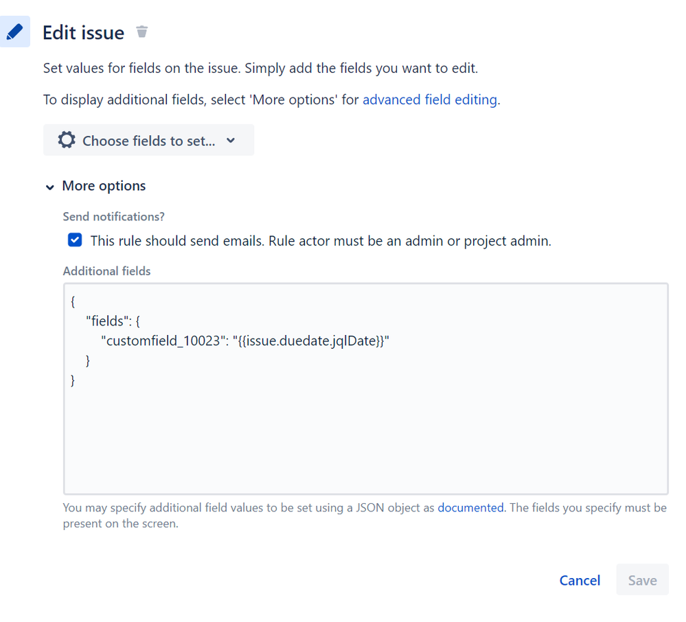

I am trying to copy date from 2 existing fields to "Target Start" and "Target End" dates. But I can't find these two fields in the drop down "Choose Fields to Set" in the "Edit Section" of the Automation.
I also see a message at the bottom of the drop down that if you can't find all the fields, use the "Advanced" section. Where can I find it?

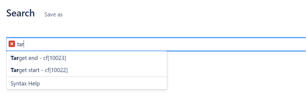

Hi @Venky ,
You can update your field like below
To find your field id, open advance issue search with JQL, type your field name
cf[xxx] is your field id -> it means Target start = customfield_10022, Target end = customfield_10023.
Remeber that you have to format your date value to yyyy-MM-dd, your smart value should be issue.your_source_date_field.jqlDate (your_source_date_field like due, created, customfield_xxx,...)
Hope this helps!
