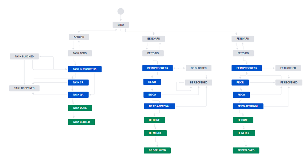

Also the error message is suggesting the destination status should be 'CR' but I could not recognize such workflow step from your first screenshot.

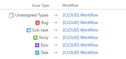

Sub-Tasks are in the same workflow as the other tasks (can be moved by team members) - see attached 2021-07-02 08_55_42-Window.png.
I also attached the said workflow - see 2021-07-02 08_57_07-Window.png.
