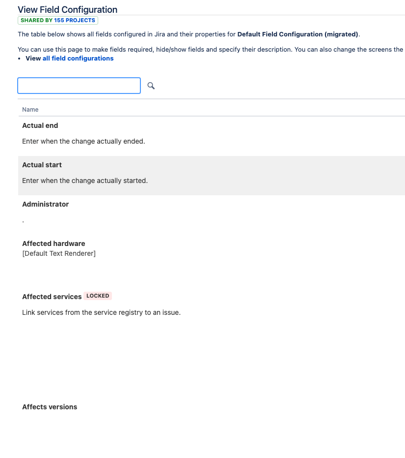

Are you able to upload a screenshot (with any sensitive information blanked out obviously)?
As Trudy mentioned, there are two places where the description could be being pulled from. Now that I've fixed my setup it's difficult to remember exactly where I had to go to sort it. A screenshot will help to remind me, and I can see what I've got in my setup too.
The Field "Administrator" must have a Description, when i save a Blank field. then it says migrated on XXX again.
The problem I had was that deleting the description didn't actually do a delete. Each time I hit Save it would return.
Rather than deleting it from the Field Configuration page, I had to also delete it from the Custom Fields page.
It seems that any description in the Customer Field Detail is added, as well as anything listed in the Field Configuration,
