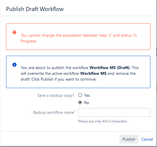

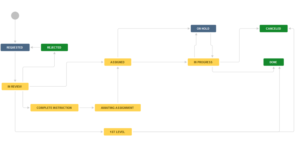

for a Service Desk project I created a new workflow. Unfortunately I can't save it and I'm not understanding the error massage:
This ist the workflow:
And this is the error massage:
Could you please help me?
Thank you in advance,
BR,
Nicat

What is the difference between draft workflow and published workflow?
Nicat Nagiyev January 8, 2019
Hi @Leo Diaz - Deiser,
the draft workflow is the workflow in the first picture.
And this is the published workflow:

The problem is the status Open I suppose it was removed... Try to include the Open Status and Publish... after that:
  1. Create new workflow as a copy (that way it will be inactive)
  2. Add/remove all the transitions and status you need
  3. Associate the workflow with your scheme and the issue types again to activate it
  4. Run through the wizard
  5. Done
