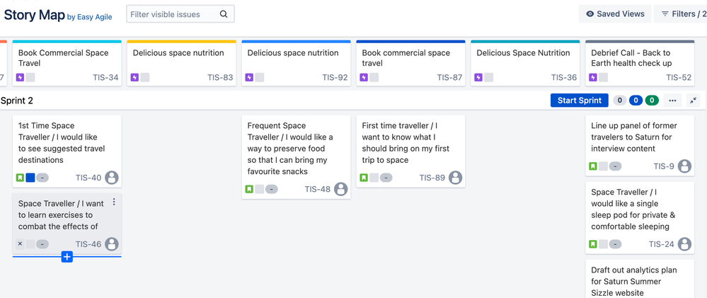

Our menu item in the sidebar looks like this:
Your Story Map would look something like this:
Hope this helps!
Jerome
