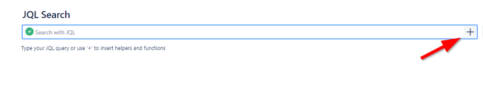

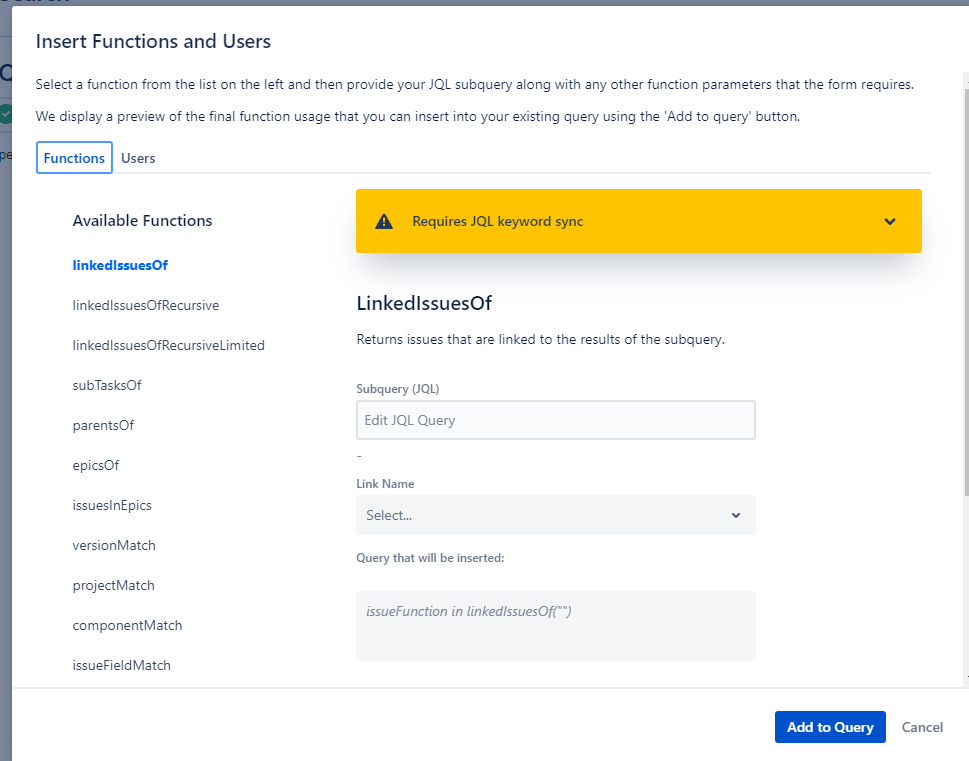

Becca April 9, 2022
To help other that may be struggling with this - I found that sometimes manually typing out the query in Jira Enhanced Search doesn't work or identify the function being used (see my above post for an example) - instead for reasons I don't know and which weren't clear via the documentation, I had to build the query using the provided query/function builder.

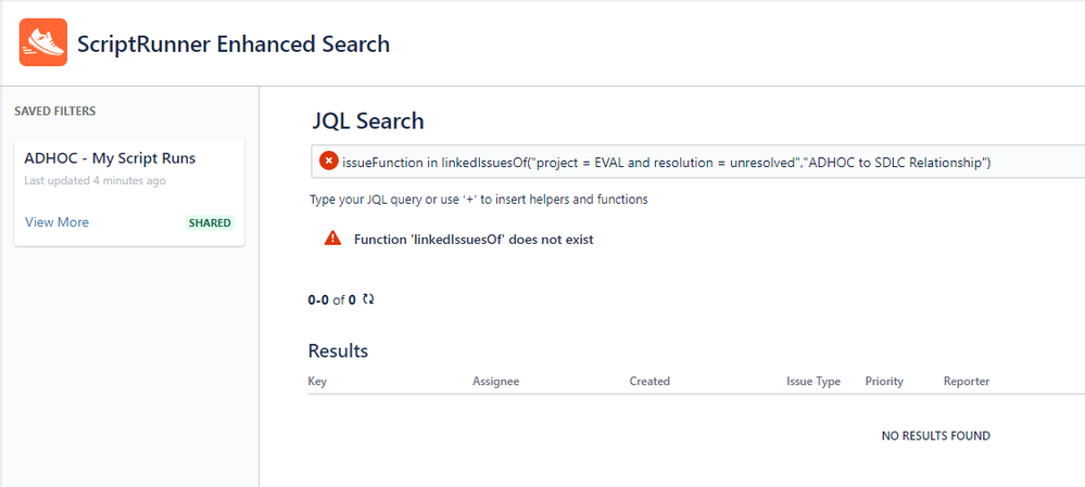

Becca April 8, 2022
We're having the same problem:
1) Are trying to use the Jira scriptrunner advanced JQL function linkedIssuesOf
2) Exact JQL =
issueFunction in linkedIssuesOf("project = EVAL and resolution = unresolved","ADHOC to SDLC Relationship")
3) We are using ScriptRunner Enhanced Search in Jira Cloud (not the regular search toolbar)
4) We're getting the result: Function 'linkedIssuesOf' does not exist
Nic Brough -Adaptavist-
April 8, 2022
Kristian's answer is still right.
