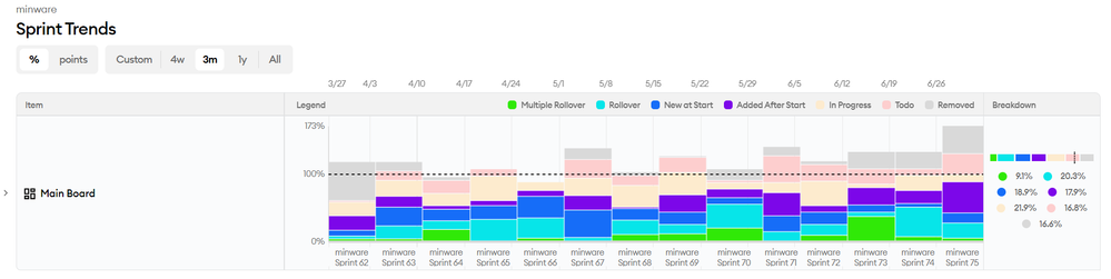

Hope you are able to find a solution! lf you are open to working with a 3rd party it's definitely something we can help with at minware. We have multiple views available but in our Sprint Trends report for example we are tracking work that is rolling over to multiple sprints (green):
We offer a free trial if you want to check it out!
