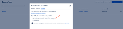

1. The context of the custom field is for all issue types in any project.

I suggest checking the following steps to troubleshoot the problem:
  1. Navigate to Jira Settings > Issues > Custom fields > Click in the custom field you created and under the Contexts tab, check if that field is not restricted in the issue-type you created:
