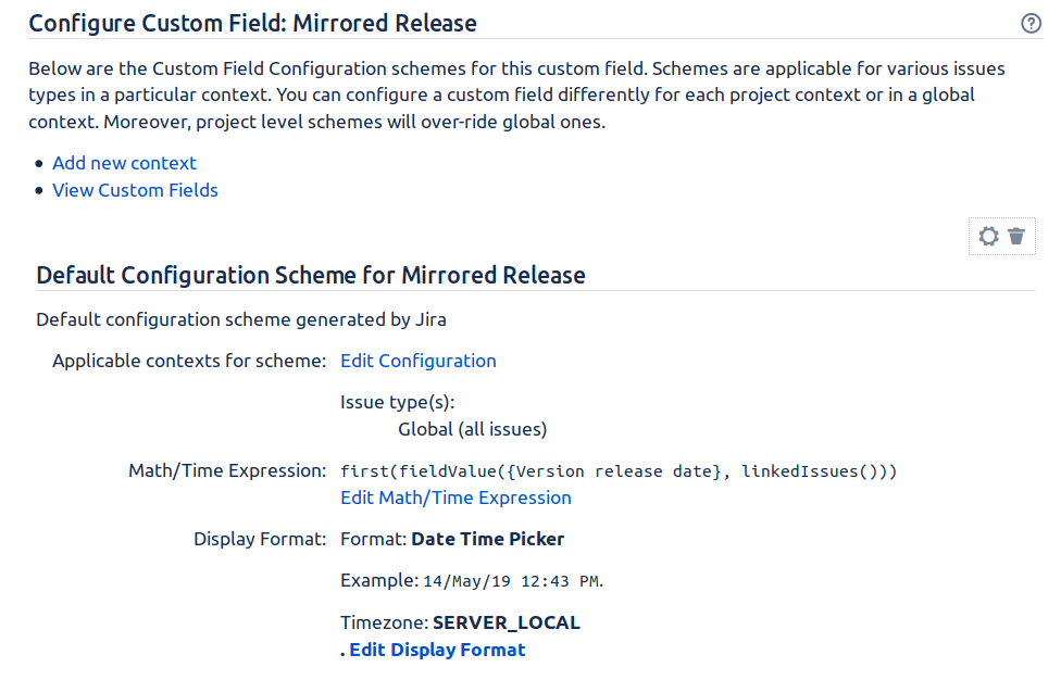

Fidel Castro
May 14, 2019
Hi @M Vijay Kumar ,
Maybe you could use Calculated Date-Time Field from JIRA Workflow Toolbox in your tasks' view screen. You could create a Calculated Date-Time Field called Mirrored Release which automatically mirrors the value of the main linked issue. This field is not editable.
You should use a configuration like this one:
I'm assuming that Release field is a Date Picker field, but we can this same solution with any other type of field.
The expression used in this example is:
first(fieldValue({nnnnn}, linkedIssues()))
replacing nnnnn with the field code of Release. We can also select a particular linked issue using any filtering criteria. If you need help for doing it, give me more details, and I will give you the exact configuration required.
