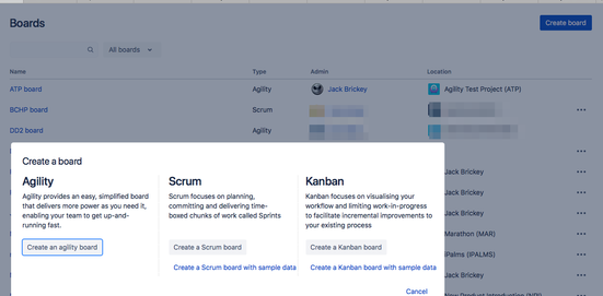

since you are on cloud do the following
  1. click on magnifying glass
  2. select view all boards
  3. select Create Board
  4. you should see the following and then select Kanban

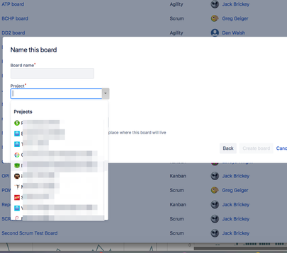

5. then select Board from existing project and you should see the following - is this where you say you are not seeing your project in the Project field?
