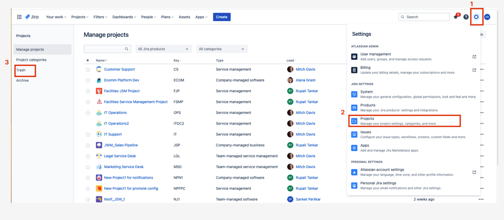

As shown in the above image
You will then be able to see all the projects in the Trash bin, for the specific project you want to restore back, click on the 3 dots (...) on the right side of the project and you will see the "Restore" option.
Remember any project not available in the trash bin is not recoverable.
