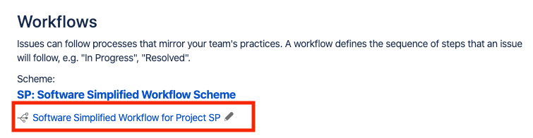

Once you go back to your project, click on Summary then click on the workflow (not workflow scheme). Something similar to my screenshot below:

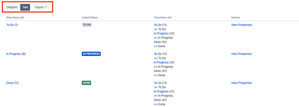

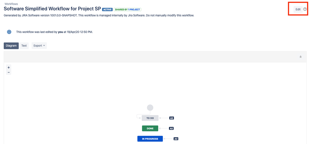

Then you will see a screen like the following, make sure to select diagram. You can add statuses using text mode as well. Right now I am trying to make it easy for you
Screen Shot 2020-04-20 at 11.21.38 AM.pngClick Diagram, then click on "Edit"

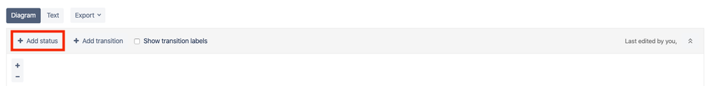

Once you edit your workflow, click on "Add status". You should be able to see on the dropdown all the statuses available in your instance.

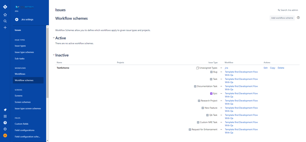

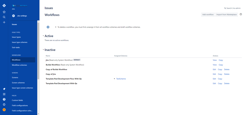

Hi Fadoua, thanks for much for trying to help. So I've already many statuses. The problem seems to be with the workflows.No matter what I do I can't get away from the default un-editable workflow.
Where exactly is the "Summary" you refer to here: Once you go back to your project, click on Summary then click on the workflow (not workflow scheme). Something similar to my screenshot below:
Here is my Workflow and Workflow Schemes I cannot ever get them to appear differentl. thank you!!!
Kevin April 20, 2020
