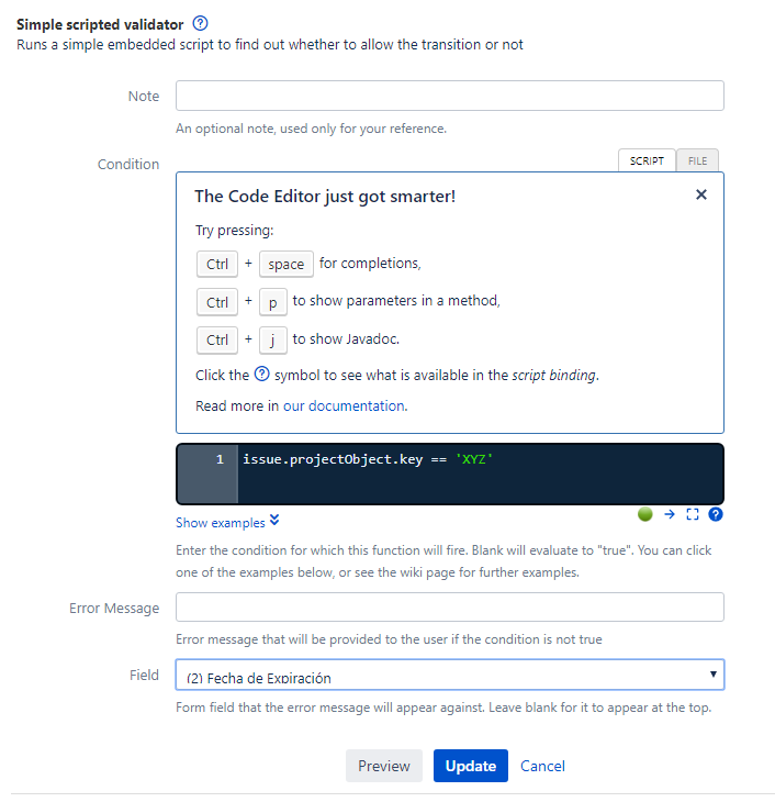

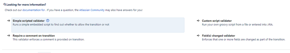

With scriptrunner you can make a validation depending on a condition.
