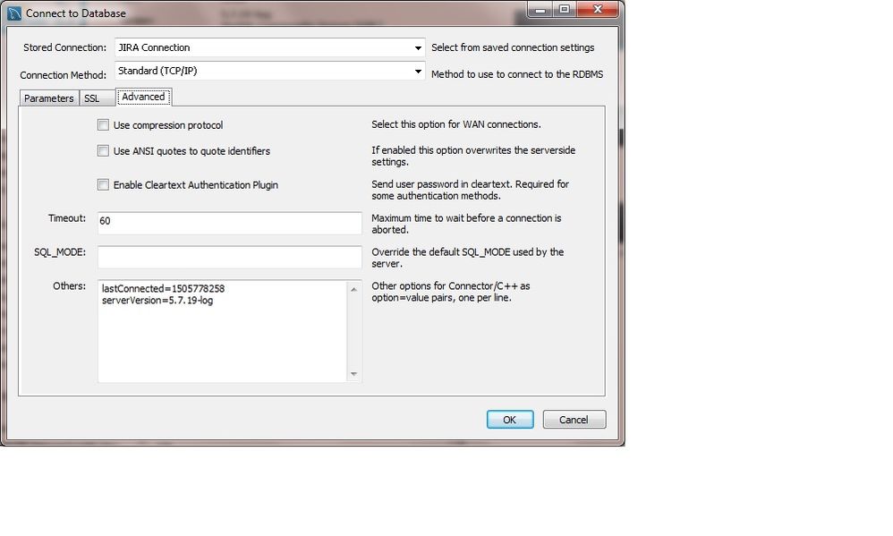

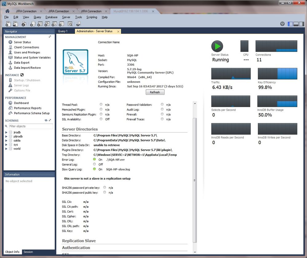

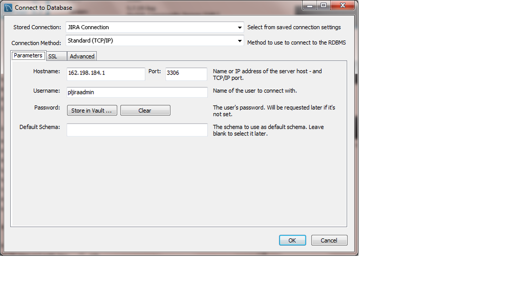

Hi Brant,
I switched the ssl to off in the workbench. I don't have access to a connection string to add the useSSL command. I've attached screen shots to show my entries into the Jira Configuration tool and data from the workbench.
