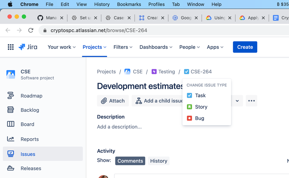

when I click on the little checkmark icon labelled "Task - Change Issue Type", I get 3 choices: Task/Story/Bug
why don't I see Sub-task? I have subtasks enabled. if I click Settings/Issues/Sub-tasks, I see:
"Sub-Tasks are currently turned ON"
so what else do I need for Sub-tasks to show up on the menu so I can convert my issue to a sub-task?

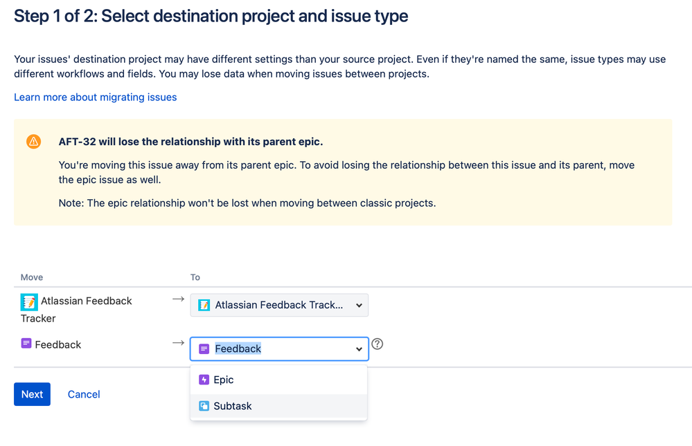

@Erick Calder it's possible to convert an issue to a sub-task for Team Managed projects via the "Move" option is the issue's detail view.
It's a 2-step process and screenshots below should help walk you through the how to make the conversion:

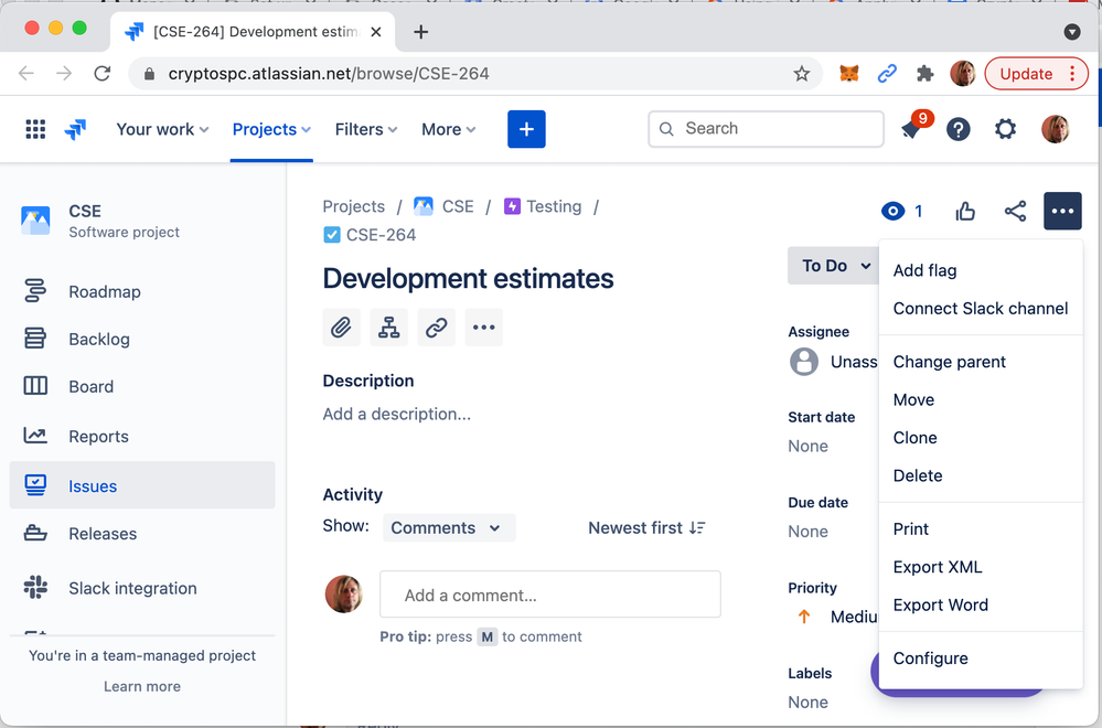

by "the tools menu" I presume you mean the ellipsis all the way at the top right of the window. that pulls down a menu with items like Move, Clone, Delete, Change Parent etc. there is no Convert to Subtask" there

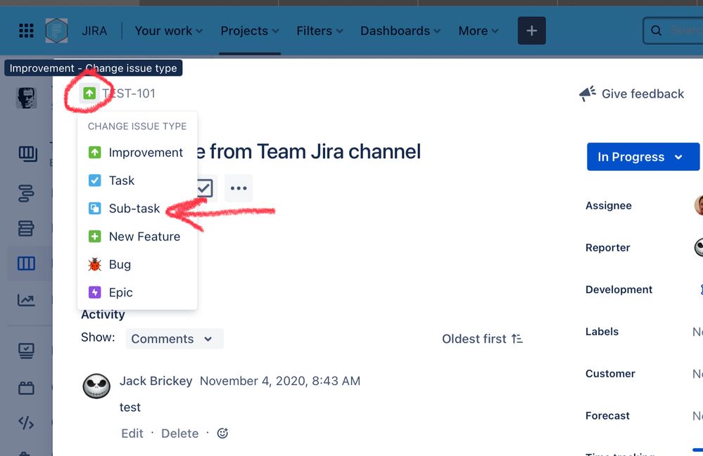

aside from that, I'm told here I should be able to just change the type:
the above is what I see. as you can see, I don't see a choice of Sub-task
Ah, yes, ok. Team-managed projects don't have the convert option for their issues.
gosh. how frustrating. so do I upgrade? what do I have to do? I need to be able to manage things. this is so useless!!!
Team-managed projects really are very simple and lack a lot of functionality. I regularly have to say "they're not ready for real usage yet", although Atlassian are gradually adding the functions we need to them.
I'm afraid the only useful answer here is "use a company-managed project instead".
