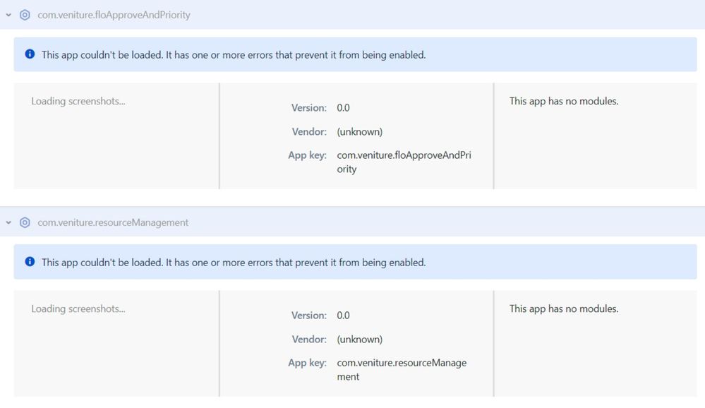

I was developing custom app for JIRA. At some point i decided to rename the app but for some reason i am unable to remove the app.
Steps i have tried:
I cleared plugin caches in home directory but i did not help.
I can't see these plugins in installed plugins directory as well.
Did restart JIRA.
Renamed project and upload it again.
It says : This app couldn't be loaded. It has one or more errors that prevent it from being enabled.

I changed some classes in source code then installed plugin again succesfully after that i was able to uninstall. Still do not know the initial reason though
