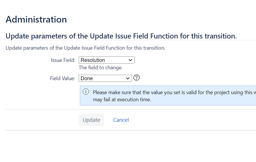

Go to workflow of the project and diagram view- click on the transition to the status. then under post functions make sure you add a rule for resolution set to donejira1.png
Like Jeff Abbott likes this
Jeff Abbott September 30, 2020
Well, that does work. Any idea why the script did not work?
