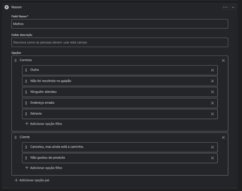

Hi there! I need some help with cascading fields in automation, I've created the cascading field "Reason", as you can see in the picture:

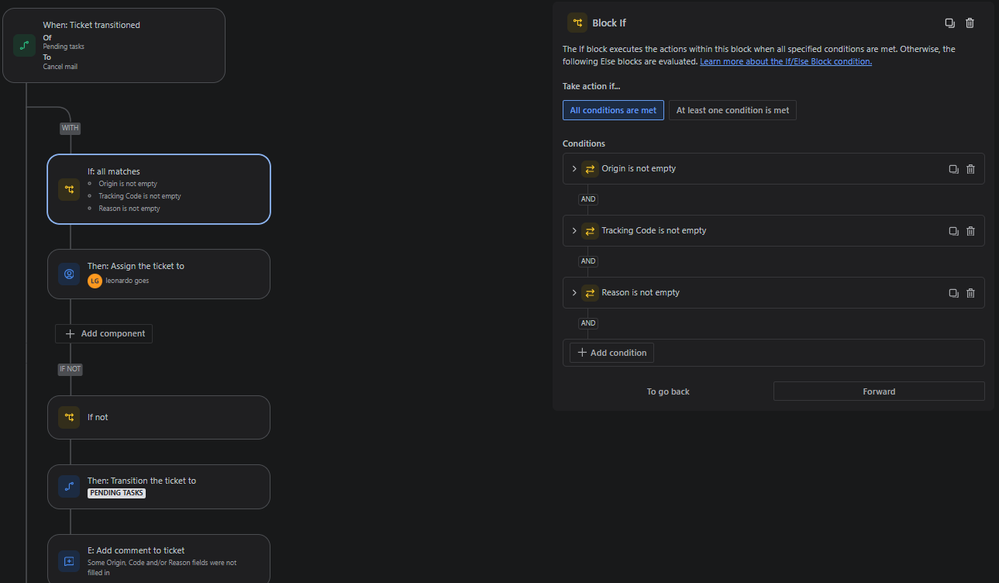

And then on the automation rule, I just wanted that when transitioned, this field couldn’t be empty, so I did like this:

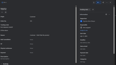

However, it’s not working right, even with the field filled:

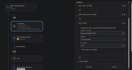

Hii Hari! Thank you so much for your anwser, it worked here! The only thing I did was to look up for the field propor custom name in the smart values { } -> custom fields.
I belive the issue of not finding it before was because there's in another board one field with the same name.
Thank you both @Hari Krishna and @Marc - Devoteam !

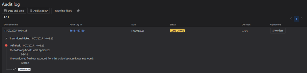

The message in the audit log says it can't find the field.
See KB, resolve-automation-rule-failure-due-to-missing-configured-field-in-jsm-cloud
