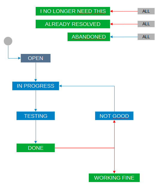

Quick suggestion for what you might be trying to achieve, as far as I've understood (of course you'll have to use your actual statuses).
The blue transitions must have a condition that users in the group customers (for example) can't execute them. The red transitions mus have a condition that ONLY the users in that group can execute them.
I hope it helps.
imagen-2020-10-30-102307
akunnari October 30, 2020
This is pretty much what I want, but the problem is, that our workers could transition from "in progress" to "working fine" inside our own ERP System. What the interface would have to do then is to know hwo these 2 status are connected, execute the statuschange from "in progress" to "testing" to "done" to "wokring fine" but there is already a catch. It would be a hella much work to define every possible transition chain we have in our company (we have like 25 internal staus' a ticket can have) and thats why I tried to create this solution.
What the customer should be able to do is to activate the transition "in testing" --> "Good/bad" which would internally go from "in testing" to "transition" to "good/bad" without the customer even noticing, that the ticket was ever in the "transition" state
Iago Docando
October 30, 2020
I believe you're overthinking it a bit :)
Instead of complicated automated routes A-B-C-D or A-B-C-E just create as many A-D or A-E transitions as you need, of course propprerly configuring any condition or postfunction.
I might be missing something from your explanation but in general I would advise you to not to create any status if your process doesn't take into account moving the issue to that status. I mean, either tell the user that he must update the status to "testing" when he's about to start testing or remove the status entirely and go directly from "in progress" to "working fine" once he's done testing (just an example, do what you  think suit best you actual process). In this second case you could use something like a custom screen to promt the user for info like testing start date / end date / actual time spent in testing between those dates... everything goes.
Of course jira (or whatever other tool) is just used to document and trace the processes we've previously designed, they aren't the processes themselves.
Hi @Thorsten Letschert _Decadis AG_ ,
so there is no real difference between these 2 scenarios except for a unified workflow.
Since we can transition between any status in our own System we want that to be possible in jira as well. So that we dont have to hardcode specific transition chains into the inferface. Like when our own ticket goes from "in development" to "done" the interface should just be able to transition from the one status in jira to the other, without having to first go through the entire workflow (in development" "internal testing" ... "in shipping" ... "done" ) in jira. Thats the reason of the "transition" status.
We will save the IDs for the transitions from the "transition" status to every other status in our erp system, same with the one transitionID from every status to "transition". Now if I would make extra transitions like the ones in Sceanario 1 following problem would occure:
1. I cannot create a transition from "in testing" to "un-/successfull" if both are accessible from every status ("there is already a transition between these status'" error occures)
2. To overcome this problem I would have to delete the possibility to transfer into these ("un-/successfull") from every other status.
3.This would lead to the nessecity to create transitions from every OTHER status to "successfull" and "unsuccessfull" which would lead to a million different transistion IDs. (Eg. "from in development to unsuccessfull" "from being analyzed to successfull")
Our workflow is defined, but our workers are not forbidden from doing "unusual transitions" since every transition might someday have a use-case. We don't usually make such transitions, but since we are using an interface between these two systems, we have to make it as robust as possible. It needs to know how to handel these situations without having a table inside a database with a million different combinations for transitions. Thats the reason I would like to only have this central "hub" of transitions, since it would limit the amount of data we need to store.
