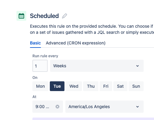

With Automation you can use a Schedule trigger to create a new instance of that task in a project based on the frequency you desire. If the issue needs to be created every weekday, you can create a schedule for that.
Follow the trigger with a Create Issue action and specify the information you want in the issue. If the information is static, that is simple. If the information is variable, that can impact the complexity.

Tasks that have the same schedule (i.e. all tasks that need to be created daily) could be handled by one rule, so you would not necessarily need a rule for each task. If you needed to change the schedule of one task for such a rule you would have to make another rule or move the steps to another appropriately scheduled rule.

Ok, will check to use Schedule Triger in Automation, one for some tasks that are daily, other that are weekly, 3rd for monthly etc.
