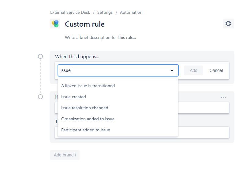

Do you know if there is such option for JIRA Service Desk 3.3.0? I am trying to do exactly the same thing but have a different interface and don't see such rule details. (see the screenshot attached). Any suggestions are appreciated. :)
Hello Daria,
To do the exact same thing, you will need the Automation Plugin for JIRA. The in-built automation of JIRA Service Desk does not have the assignee issue trigger.
Thank you so much for the suggestion. I'll try that!
