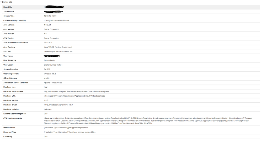

Hi All,
I am here again for an other question (with 4 questions...sorry). when I installed Jira server 6.4.14 I used the default settings and the situation is this now.
is it possible to change the encoding from Cp1252 to UTF-8?
is it possible to change the Database type from hsql to MySQL?
is there an other way rather than to Uninstall JIRA server and Install again with new encoding and type of db?
if yes, is it possible to "export" and after "import" settings like users, workflows (I checked is it possible), Schemes of Issue, Workflow, Screen, issue type screen, permission and custom fields?
thanks a lot, regards
Marco
