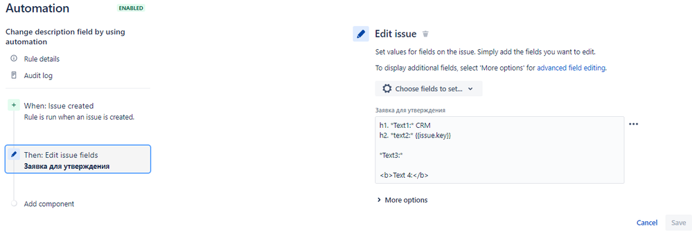

I'm making automation rule which is editing custom field (type - Text Field (multi-line)).
Need the text to be in a certain format (bold, italic, etc). But when I tried to add tags (ex. h1. /h2. / *bold* / <b>bold</b> etc), as a result, the text received the same text that was written in the rule without changing the format.
It there a solution to change text style by using automation rule?
My attempts to automation:

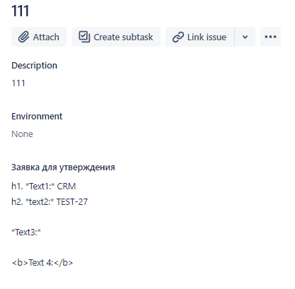

The result:
Hello! To get formatted text, you need to change the renderer of your custom field to be Wiki Style renderer. Once you do that you can use formatting such as *text*.
Great thanks, it works!
