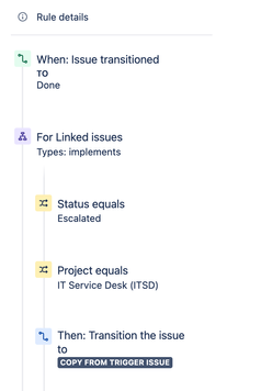

Hi @Houssein Barkallah
That is something you can do with an automation rule. That might look somewhat like this:
Hope this helps!

Walter Buggenhout
October 17, 2022
You could also just switch the initial trigger: instead of issue transitioneduse Field value changed:
Do take some time to dig a little deeper into the magic powers of Automation; there's a lot of possibilities there ...
