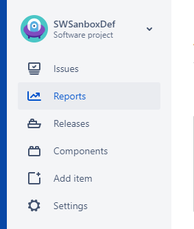

Below is a screenshot of the menu bar. It IS a software project, but without the board.
I am very new at Jira, so my apologies if I have overlooked something obvious.
Go back to the dashboard (out of the project) and look for the "boards" option there. Go into it and you should be offered "create new board" - best bet is to create one based on your project (rather than a filter or creating a new project). Because the filter it generates is very clearly for your project, you should find the project now defaults to using that one.
Thanks again Nic for your reply.
Looks like the new Jira 'Experience' layout did not offer me the ' boards' option.
When I switched back to the classic mode, the board dropdown box is there.
In the meantime, I found that within the new Jira layout, I can go to the same boards screen by search->boards->view all boards. And indeed there I can create a new board.
Took me a while to get there, but problem solved ;-) thanks
