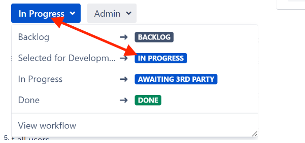

I am using the terminology that the Jira UI shows, which is Linked category. But I will describe the issue from the start:
There are other workflows with a status of In Progress. The problem is that the status of In Progress in other workflows has now changed to Awaiting 3rd Party. Can someone please tell me how I resolve this and correct the other workflows to show a status of In Progress on the boards again? Thank you!

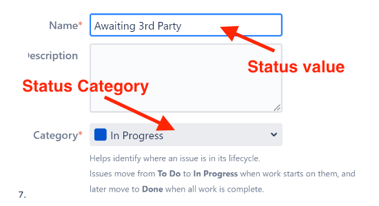

Hello @Angie Elliott
As I said, there is a Status value and a Status Category.
"In Progress" can be used as a Status Value as shown here:
"In Progress" is also the name of a Status Category under which all Status values that equate to work is in progress are group. A Status value assigned to the "In Progress" Status Category shows up as a blue (vs. gray or green) lozenge, as shown above for both the "In Progress" and "Awaiting 3rd Party" Status values.

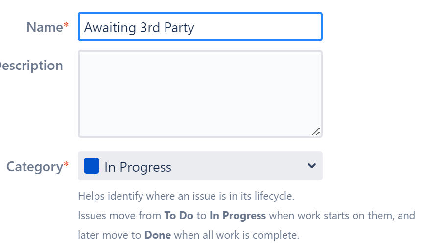

You can change the Status Category to which a Status Value is assigned here:
If you change the Status value (Name) itself in the above dialog, then everywhere that previously showed "Awaiting 3rd Party" as a selectable Status gets changed to reflect the new name.
Based on the first image I copied above, you had at that point two Status value; In Progress and Awaiting 3rd Party, both included in the "In Progress" status category.
This suggests that you may have made another change that you did not detail - naming editing an "In Progress" Status value and changing its Name to "Awaiting 3rd Party".
A Jira Administrator can review all the Status values/names and their associated Status Category by navigating to the gear icon (Jira Administration) and selecting Issues, then finding the Issue Status option. From there each Status value can be edited to change its Name and Category. Note that if you make a change there, that will be reflected in all project workflows that use that Status.
