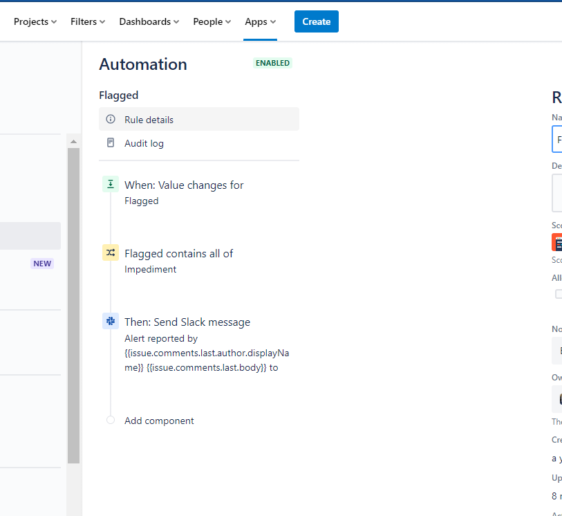

Hi All,
Please find my automation rule that i created, and it is not working please advice

What does the audit log indicate for a triggered rule that you would expect to succeed?
it gave me error as i have two similar field for "flagged" and i found them locked, so how can i fix this ?
Ah so do you have a custom field “flagged”? If so I highly recommend not doing that. You really should never create a custom field named the same as a system field. This is a good example of why. As John mentioned you may want to open a ticket with Atlassian just to report this. However I suspect the answer will be to change the name of your custom field.
Oh…I see in your other related post that you are showing two system fields labeled flagged. Sure seems odd and agree to report to Atlassian.
