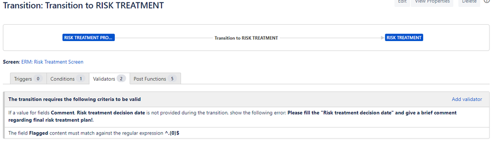

First, we'll add the flagged validator on your workflow...
^.{0}$

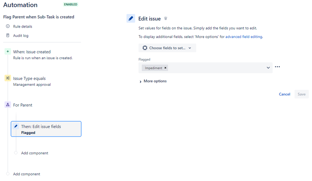

Rule #1: Flag Parent when Sub-Task is created
We want the flag to be set as soon as a sub-task exists:

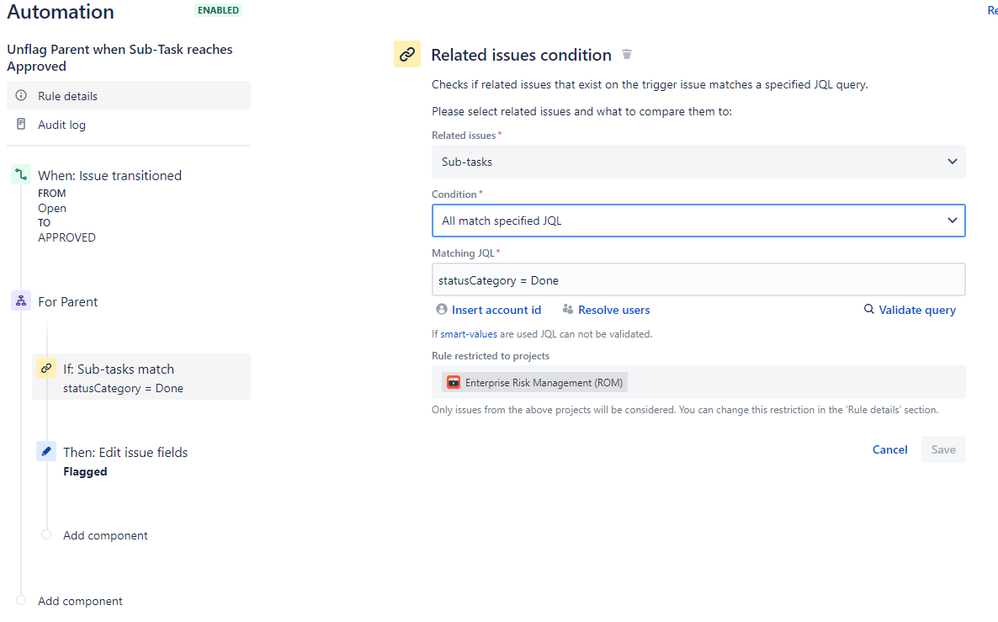

Rule #2: Unflag Parent when Sub-Task reaches Approved
This will only unflag the parent when the last sub-task has transitioned to APPROVED status

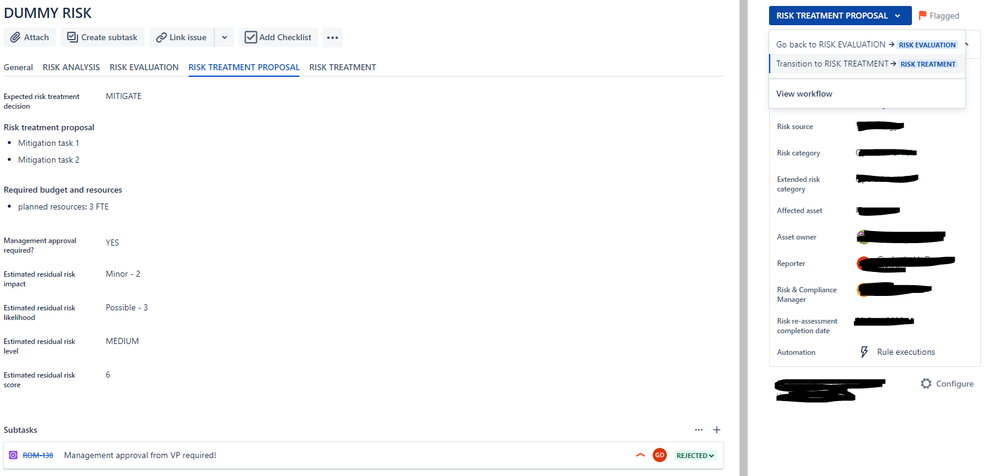

@Mark Segallsomehow that didn't worked. Should I add the field "flagged" to the Risk Screen? Here are the screenshots from them, what I've been set so far:
This approval subtask will be created automatically, when specific conditions are are met, (likewise risk score is higher than 16 etc.) but this doesn't matter, I think.
Rule status is for both rules CONFIG CHANGE, so these rules doesn't executed, I assume.

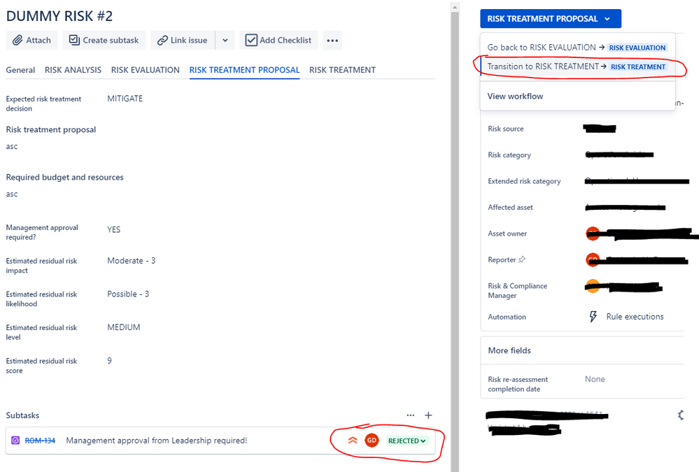

@Mark SegallNow I'm one step ahed, so parent issue get flagged now. But I'm still able to transit the issue, even approval subtask is rejected as you can see at the screenshot below. What could be the reason?
You know what... I had to use a validator in my past and your use case would need a condition. With a validator, the option is still there, but it will error on you if you try to select it. Whereas a condition will hide the status altogether.
So, let's do this:
Sorry about that.
