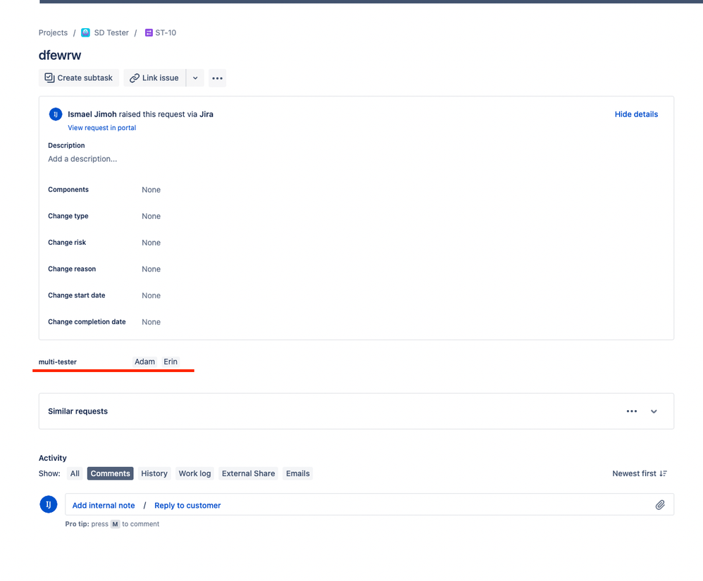

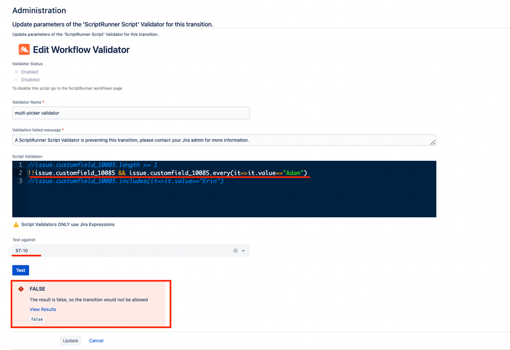

Ismael Jimoh
October 26, 2022
Please see the configuration and replies below:
Issue View

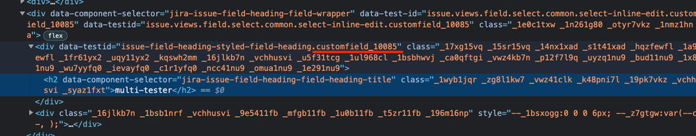

Confirming the customfield id from Browser console
The query we agreed to work with.
The field is a multi-select custom field as you saw above and Adam is an option from the field. However as you saw, I still get an error false though the value is present.
I will appreciate it if you have any further suggestions.
Thanks.
Sayed Bares _ServiceRocket_
October 26, 2022
@Ismael Jimoh thanks for the screenshot.
The reason for that is that you have other values besides Adam, which is Erin.
If you want to pass the validator as long as you have Adam as a value, then use this code instead:
!!issue.customfield_10085 && issue.customfield_10085.some(it=>it.value=="Adam")
