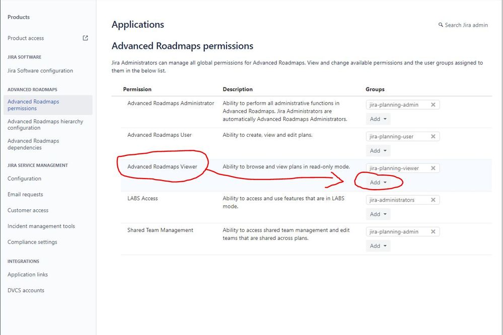

@Filip Pokorny Your solution worked for me! I was able to add the users to the 'Advanced Roadmaps Viewer' permission and the child Epics appeared to the users. Thank you again so much!
Here are the steps I followed:
Hi @Josh Muir , @Filip Pokorny ,
If we add the user in the vier permission . There was able see the all plans in the JIRA .
Can you suggest me in this .
Now the users are able to see the child issue under the parent ticket .
How i can restrict the user . So that there should not see all the plans.
@kiranmai.genkolla Once you've created a plan, you can go to the Plan, then navigate on the left sidebar to 'Plan settings' > 'Permissions'. From there you can modify individual plan edit and view permissions.
