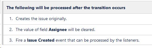

I put 'Clear Field Value' post-function for the Create transition and clear the Assignee field there. But it just does nothing. Any new issue is always assigned to the project lead after creation.
I have tried to change the position of the post-function, even putting it as the latest in the list. No results.

I expected something like this for Automation rules. But it is interesting why the PF doesn't work in this situation as I expect that the following 'Creates the issue originally' should be finished (including the default assign) BEFORE the next PF is executed.
It doesn't work because it run async. If that was going to work, I would place the PF after the "FIre Issue Created" event:
Try that and let me know if that works. :/
I tried it from the very beginning ;-) No result
