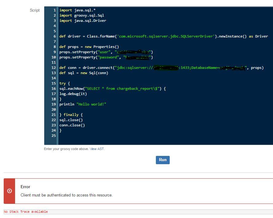

Groovy Script to run select query to an external db from Script Console is showing error as below
Client must be authenticated to access this resource
Although db login credentials are provided in the script
On the Jira server, via sql studio able to login to this external db schema using same credentials.
But still there seems to be this error is caused by some access issue
That looks like an error in JIRA, rather than your script. It suggests your admin access to the console script has timed out or ended before the script is finishing.
New Error occurring now as below
2017-05-23 10:44:35,621 WARN [common.UserScriptEndpoint]: Script console script failed: java.lang.ClassNotFoundException: com.microsoft.sqlserver.jdbc.SQLServerDriver at Script15.run(Script15.groovy:6)
