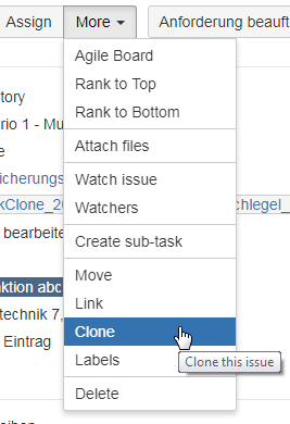

what do you see, if you click on "Clone Issue" ?

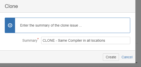

Hello Thomas,
i dont have options like your system . Please see image
Do you try to clone an issue with Sprint values?
I've tested this also in my cloud testing environment and there I also get this field, if an issue has a sprint value:
If the issue has no sprint value, the field is not visible - as it is in your screenshot.
