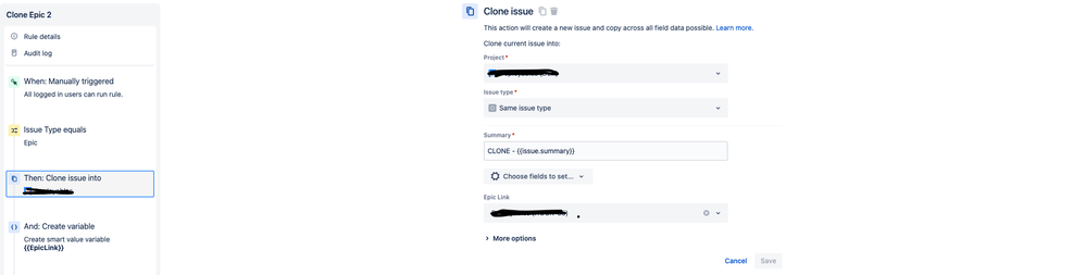

@Mark Segall , kindly need your help with my case. I have created an epic with it's child stories in a team managed project. then i moved it to a company one. now I want to clone it back to another team project and I created an automated rule for that. screenshots to follow. however when I open the epic card and go to the automation to run the rule i don't find it at all as if it doesn't exist. can you pls advice?
Thank you for starting the new question and sharing your screenshots. Am I correct that you can actually see the rule in your actions menu and that once you select it, nothing happens?
Please provide this:
If you have a rule set to execute manually and you've selected that rule from your actions, you should at least see something show up in the audit log so this is definitely a peculiar scenario.
Hello @Mark Segall ,
Nope I cannot see the rule in the action menu of the epic at all.. It doesn't come up !
I did choose that the rule to be executed manually but it doesn't show up.. another
so Here is a screenshot of the epic :
the rule shown in this pic is not the one I want to run

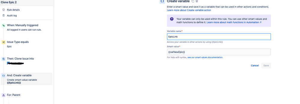

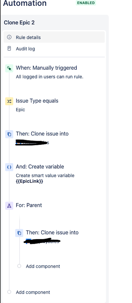

The Rule details screenshots:
Am I correct in my understanding that you created this on one project and now want to execute it on another? Under the Rule Details there's an area for Scope which determines what projects this rule will be available to. It is likely that because you created it on the original project, it is only available to that project. You would then have two options:

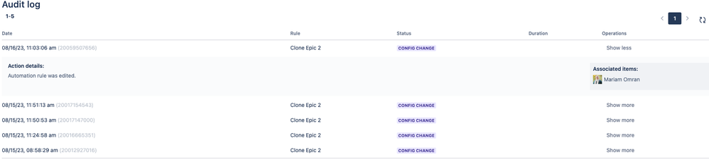

I'll try to assist you with your inquiry. You mentioned that you ran the automation rule and you weren't able to find the epic. Would you be able provide us some screenshot of the audit logs?
Also, if you can change your smart value to {{createdIssue.key}} instead of {{varNewEpic}} that might help.
Let me know how you go.
Cheers,
Francis
Hello @Francis Batilo Thank you for your support.
For some reason this is all I am getting from the audit log !
NO actual log is showing up !
That's a bit peculiar, do you mind running another automation run until it becomes available on your audit log and show us the details of it?
I keep enabling it and disconnecting it and I get the same audit log. maybe that's why it is not showen.. shall I create this automation rule somewhere else other than the Company based project settings?
That might be a good idea and if you can run it on a different project under your sandbox. From what I can see, the rule has not been triggered despite it being a manually triggered automation, which is a bit weird. I'm expecting an error message of some sort to diagnose what the error is, but that's only when the rule is executed completely.

I know !
Now I have done something different
I have created a whole new rule a blank one and started manually to create the conditions in it following cloning an epic one.
I started the 1st condition with an automatic tigger once issue is created and issue type is equal to epic.
and saved it and ran it.
and this is log !
I then changed the trigger to be manually and now I am back to square zero and shown in the log above !

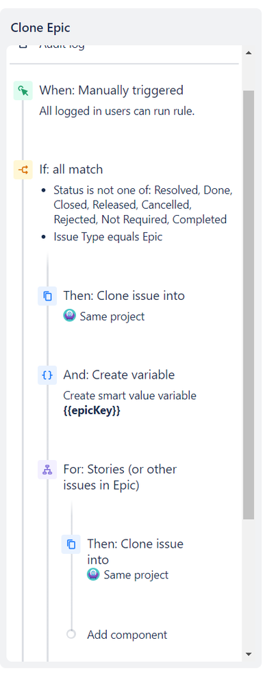

In terms of your automation rule, I think you might need to update the branching to be stories instead of For Parent (see my screenshot below).
