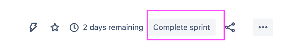

Yes, perhaps it's better to describe it by saying I have issues from Board 1 in Board 2. I create issues in Board 1. To connect them to colleagues from another team, I add the appropriate component (in addition to the component I use to filter the issues on my board). They then add the issue to a sprint when they have the capacity for it.
So in the end, these issues have two components, allowing them to appear in two boards. The issue was initially created in Board 1 and is now also displayed in a sprint on Board 2.
However, when I attempt to complete the sprint from Board 2, the 'Complete Sprint' option is not available; it has a grey background (as seen in the pink box in the screenshot). It only becomes available again when I remove the components from Board 1 from all the issues. This, in turn, leads to the problem of not being able to see the issues in Board 1 anymore.

Given that the issues are all in one project, then your ability to manage sprints should be the same in both boards.
When you hover over the Complete Sprint button and it is disabled is there any hover help that displays to explain why it is disabled?
Have you confirmed that you have only one sprint selected when you go to use the Complete Sprint button.
The filter dictates what issues will be shown in the board. If you want the issues displayed in both boards, as you indicated in your original post, then the issues have to match the criteria of both filters.
A sprint will show in any Scrum board where the board's filter matches an issue in the sprint. But only the issues in the sprint that match the boards filter will be displayed.
So if you have issue PB23-111 with two Component values assigned, and the Component values assigned means that it matches the filter for both boards, and you assign that issue to a sprint in either board, then that sprint will show in both boards. You will be able to manage the sprint in either board. So, while you see the issue in a sprint in two different boards, it is actually one sprint showing up in two board rather than two separate sprints.
I think we are going to need concrete examples of this problem when it is actually occurring to finish debugging it.
