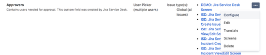

Per your description, I believe you are talking about a field with pre-selected options and not a free text. Try to perform the steps below so we can have more details if we can select the options provided by that field:
- Navigate to JIRA Settings > Issues > Custom Fields OR type GG > Custom fields
- Check if you are able to find the mentioned field. If you find it, click on the three dots > Configure (See screenshot below) and check if you are able to add or remove the options provided by the mentioned field:
If you are not able to find it in the Custom fields page, perform the following:
- Navigate to your project > Project Settings > Fields > Actions > Edit
- Find the Account field and provide us a screenshot of the description.
