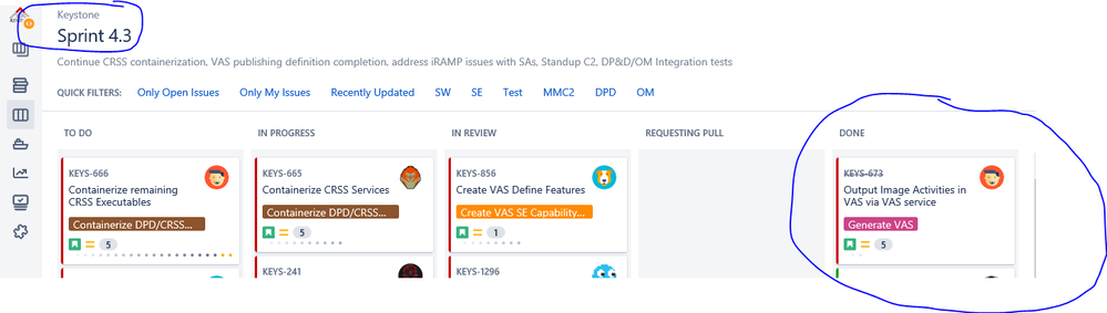

I have a story that was completed the last day of sprint 4.2. it shows up on the sprint 4.2 sprint report (burndown) chart but also shows up on the sprint 4.3 (active sprint) board in the done column. It was originally assigned to sprint 4.3 but moved to sprint 4.2. The only sprint showing in the record is sprint 4.2.
Any idea on why this story is showing up on the sprint 4.3 board? Where are the points being recorded?

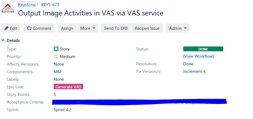

does the ticket have a resolution in place? that report works based on ticket resolution rather than ticket status.
Thanks for the quick reply!
Yes, the resolution is set to "Done".
can you provide some screenshots? might help to understand the issue. I would say, one of the ticket and one for each report

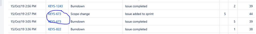

The bottom one is from the Sprint 4.2 sprint report. the page was too big to screen shot the top.
Within the ticket check the history tab, last image shows that the ticket got added after the sprint started (scope change) and then resolved. Maybe checking there will help you identify who did it and therefore... why.
Adding it to sprint 4.2 was valid, it was pulled into that sprint as work completed. The issue is that it is also showing up on the sprint 4.3 active sprint board. Why would that be when it was completed in sprint 4.2?
as mentioned, check the ticket history, if the ticket would have been pulled from sprint 4.2 to 4.3, then it wouldn't be considered as a scope change as the report shows. What I read from what I see, is that ticket was added to 4.3 after the sprint started. Maybe someone reopened it and decided to add it no that sprint in order to close it again? what do you have on the history tab?
