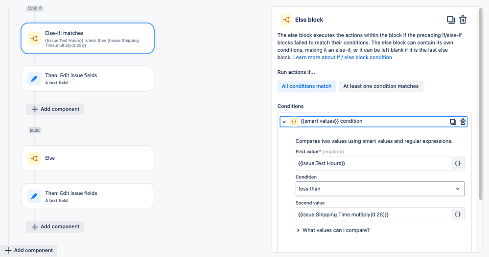

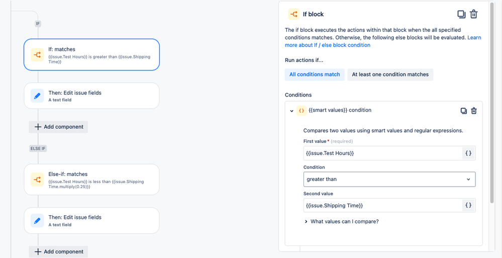

Trudy Claspill
April 15, 2024
Hello @Ray Balmeo Cagayon
You can do this with an Automation Rule.
https://support.atlassian.com/cloud-automation/docs/jira-cloud-automation/
How do you want to trigger the rule?
  1. Do you want to run it periodically, on a schedule, and have it check a set of issues? If so, how would you determine what issue to check?
  2. Do you want it to recheck individual issue based on some action/event that has happened with the individual issue? If so, what would that event be?
To actually set the Tool Status field you could use an IF-ELSE construct.
https://support.atlassian.com/cloud-automation/docs/jira-automation-conditions/#If-else-block
Where I have the Edit Issue Fields action, that is where you would set the value of the Tool Status field.
Screenshot 2024-04-15 at 4.20.58 PM.pngScreenshot 2024-04-15 at 4.21.30 PM.png
