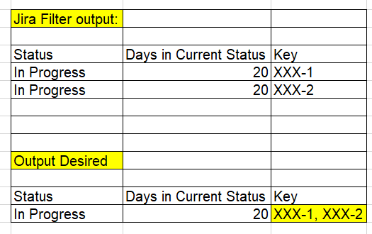

I have a Jira Filter in my Wiki that returns the below:
Status, Days in Current Status, Key
so a sample data set can look like:
In Progress, 20, XXX-1
In Progress, 20, XXX-2
I would like to use a table transformer to get the output like this(the keys to be concatenated in one row)
Status Days in Current Status Key
In Progress 20 XXX-1,XXX-2
Any ideas? Much appreciated!

these are not 2 seperate columns though. It is the same column but 2 seperate rows. any ideas?
thank you!
Please, give the screenshot of the source table (manually created with dummy data but a screenshot of a table for me to understand what text goes to which cell) and the desired result table.
If you mean that the source table looks like:
Status | Days in Current Status | Key
In Progress | 20 | XXX-1
In Progress | 20 | XXX-2
And you want to get:
In Progress | 20 | XXX-1, XXX-2
Then you need a unique field to group your keys. For example, to group all the keys that have the IN PROGRESS status or all the keys that have 20 days in this or that status.

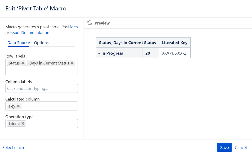

If this is the case, then you may use the Pivot Table macro with a more friendly UI.
You may try the following settings for the Pivot Table macro then:
