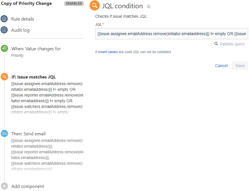

I am currently trying to create this via a JQL query that reads
{{issue.assignee.emailAddress.remove(initiator.emailaddress)}} != empty OR {{issue.reporter.emailAddress.remove(initiator.emailaddress)}} != empty OR {{issue.watchers.emailAddress.remove(initiator.emailaddress)}} != empty
However I am getting the bug
(!= empty OR reporter@example.com != empty OR watcher1@example.com, watcher2@example.com != empty))" - Error in the JQL Query: Expecting a field name but got '!='. You must surround '!=' in quotation marks to use it as a field name. (line 1, character 27)
I am the assignee in my test ticket, and it seems this rule is removing my name entirely, so it is creating a bug. How should I fix my JQL, or is there an easier way to do this?

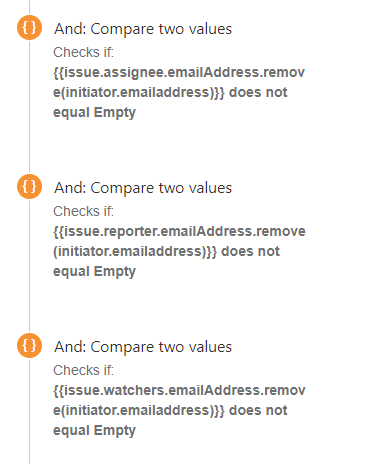

I also previous tried to do it via multiple Advanced Compare Conditions, but could not add OR functionality to this.

Thank you for the suggestion. I tried doing it with Advanced Compare Conditions, but could not figure out how to use OR logic with this. I am trying to make the rule trigger when any one of the following is true, not when all three are true.
That is why I originally tried using JQL, so that I could use OR functionality.
Sadly, there is no built-in OR for condition rule components...but there is a built-in OR function that can be used with conditional logic. Sorry if that is confusing.

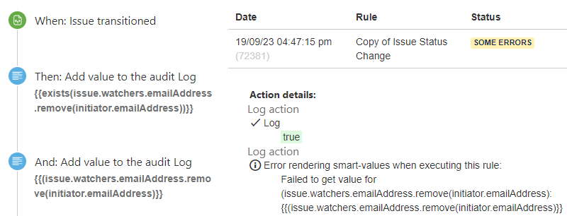

I tried this, but it appears that the EXISTS function is always returning true. In the screenshot below, you can see the first audit log evaluating the smart value existing as true, however the second log is erroring out even though it is trying to evaluate the exact same smart value.
Do you have a link to the EXISTS documentation? I tried searching for that but could not find it.
Also, what does the # in your {{#if...}} do? I also saw that in the OR documentation but could not find its purpose.
Regarding that expression collapsing to always true, I believe that is because after the remove() happens, you are left with an empty string, rather than null...and that would always exist. And so another method must be used...

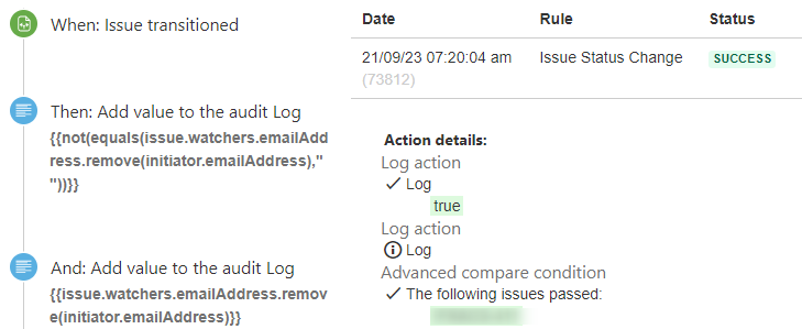

Sorry, spoke too soon. It appears that the assignee and reporter portions work correctly, but the watchers part still always evaluates to true, even if the value is empty.
I suspect this is because the assignee and reporter field are single user fields, and the watcher field handles multiple users.
In the below screenshot, there were no watchers but it still evaluates as true
I am glad you noticed the watcher field is a list, and so when we referenced {{issue.watchers.emailAddress}} that expanded into a list...even when empty. One work-around is to join that list into a single text string first, like this:
{{issue.watchers.emailAddress.join(",")}}
Then when the initiator's email address is removed, the string will either be empty or not, with no empty list left behind.

Here's a screenshot of the rule:
Here's a screenshot of the error:
