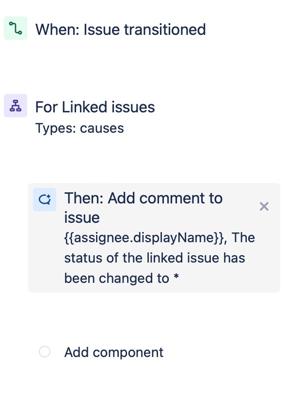

Hello @shravya chinthapatla
If I understand correctly, you want to trigger something when a linked issue is closed. For instance, notify the assignee of the original issue.
If this is the case, then please take a look at automations.
Trigger the automation to when an issue is transitioned. In your case, to Closed
Then add a new Branch / Linked issue condition, you can specify which kind of linked issues should be targeted, or you can set it on all linked issues.
Add an action component to do the thing you want the automation to do. In my case, I wanted to comment on the original issue with the status update of the linked (accessible with {{triggerissue}} ) issue.
This is how my automation looks like:
Please let me know if you if this is what you are looking for. If not, please elaborate on your desired outcome.

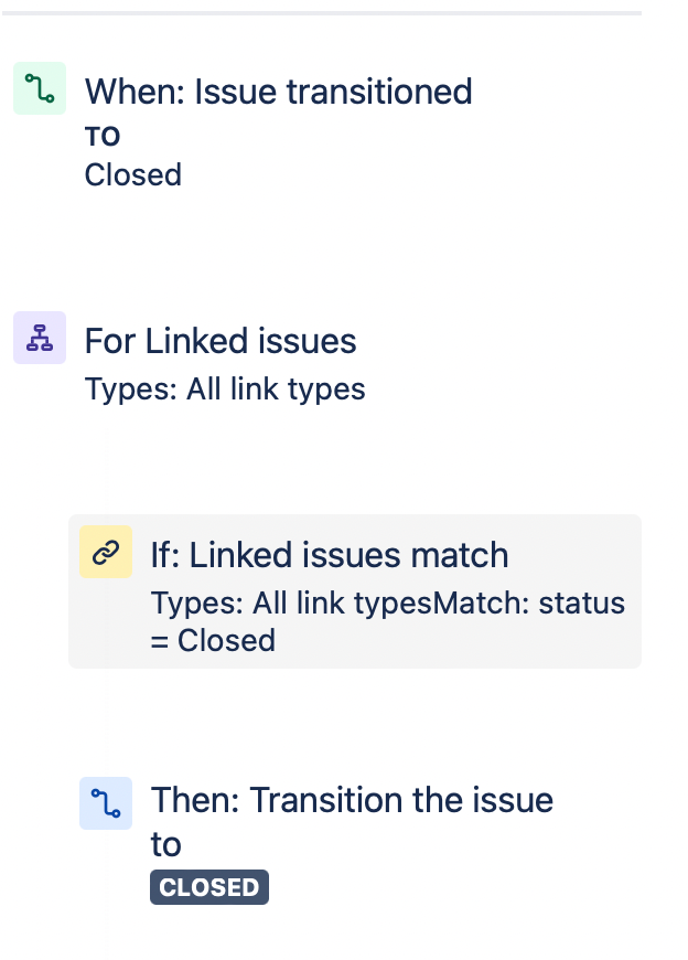

I am sure the suggestion of @Shaik Rafi will work but I do believe it is possible using the build in Automation.
From what I understand, you have a 1 on 1 relation. Meaning that there is only one linked issue. If that issue is set to done, the linked issues should also be set to done.
Here is what I would use, please give it a shot and see if this will do what you want it to:
If you do have multiple linked issues, then you need to add an additional check to make sure that it only transitions when everything is closed. Something like this should do the trick in that case:
Good luck with setting it up. Feel free to reach out if you have any more question. In the mean time, are you familiar with Atlassian's Automation Playground? There are some great automation examples available. It is worth taking a look, and of course, play around!
