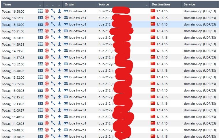

Diego Cañete
February 20, 2020
Comperndo, check this outbound traffic from our server to a server in China over UDP / 53. This is normal?
