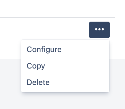

I created a KANBAN Board with a filter that only show specific epics. I did configure my dashboard (added swimlanes, columns, quick filters). There was one JIRA feature that asked me if I wanted to use the new "backlog". Today, i wanted to change the columns of my board and I have no access to the configure board screen.
I decided that I was going to copy it, thinking that I maybe corrupted it with this backlog feature. Now I have a Copy Board that is also impossible to configure and therefor I cannot delete it.
So as I really needed to start on this board, I created a new Kanban board with a filter for specific epic and I have the same issue :(
What do you think is the problem?
Thank you in advance

Thank you Jens for pointing to this discussion. I see that having this type of filter is not letting me configure the board. I must have added the filter after having configured the board for the first time. My other issue is that in the discussion above, they were able to remove the filter, but in my case I cannot access the configure at all and cannot even delete these filtered additional boards.
In the case of the referenced post the user was still able to access the Configure Board screen. In that case, when they were viewing the board display they were seeing no issues. That is not the same scenario as is being experienced here.
What is the filter you are using for the board @Mireille ?
Can you try creating a new board with that same filter and see if you still have the same problem?
@Trudy Claspill , I created 2 additional boards and they both have the same issue.
The first board, I copied the existing board (as I thought then that I might have mess up something with the "backlog" feature - I turned it on and didn't like it so I tried to remove it... so my first board, I was able to create Quick Filters, select my Swimlanes.. So I wanted to reuse that work.
As it had the same issue, I decided to create a Brand new board with the same filter thinking it would not have this issue... it does
I really would like to also be able to remove them now, as it get confusing... but I cannot delete the boards.
Because I cannot access the filter either, I cannot go and copy it, but it was something like that
project = SRMP AND "Epic Link" = SRMP-270 "Epic Link" = SRMP-271 "Epic Link" = SRMP-272 "Epic Link" = SRMP-273 "Epic Link" = SRMP-274 "Epic Link" = SRMP-275
