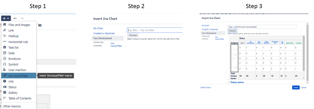

Problem: Jira two dimensional filter macro will not create and/or save setting of an existing one where the parsed JQL character length exceeds ~ 3200 characters. (Confluence version: 6.15.7 - Server | Jira Version: 7.11.1#711001-sha1:ea73d62)
Goal: Display the results of issues committed, added, completed, removed in the sprint for multiple teams within a product group using native JQL and Script Runner (so please, no comments advising trimming down the JQL).
Scenario 1: Creating a new two dimensional filter

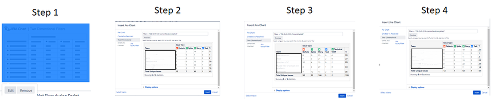

Scenario 2: Revise existing two dimensional filter
Question: If the root of the problem is the limitation on the JQL length, is there a way to adjust it?
Note: The Jira Issue/Filter will save if it is created as a simple filter (not as a two dimensional filter):
You have no choice but to get an answer about shortening the JQL - that is your only option (unless you want to rewrite every part of the Jira and Confluence code that works with JQL)
As you have scriptrunner, you might find it possible to write functions that will help you shorten it, but I could not tell you where to start, as I've not seen the filter.
