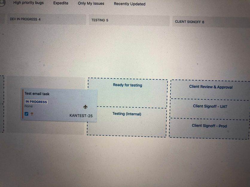

Hi there, I'm a bit confused on Transition and Status in Workflows. Aren't they kinda of repetitive? Do we really need a transition if are checking the box - Allow all statuses to transition to this one? If all conditions can be added to the All to Status link do we really need Transitions then?
See the attached image... when moving a task from Dev to Testing it giving two option... one of them is transition and one is status.

On your board above, this is not related to transitions - it's that two statuses are mapped to the same board column. You can view this as a user, but to change this you'll need to be a Board Admin:

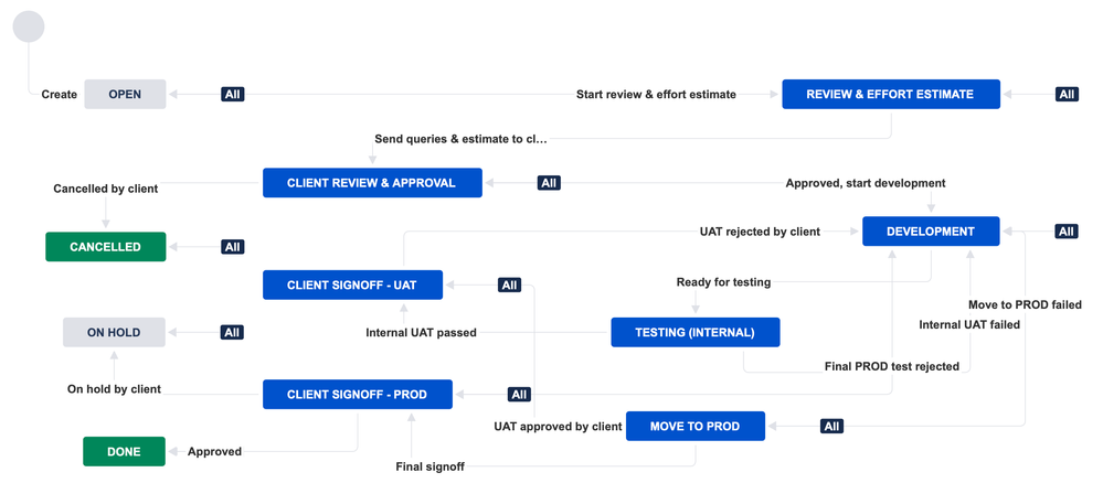

Hi @Ste Wright thanks for getting back on my Q. I'm attaching the Board and Workflow. What do you see is not correct or maybe repetitive?
Also, If all conditions can be added to the 'All to Status link' do we really need transitions then?

I'd suggest the complexity of your workflow will be the issue.
The usual issue here would be as @Ollie Guan suggested, which would cover either:
^ I can't tell if either of these is the issue for you - I would check:
I would suggest simplifying that workflow though - it looks like aside from "Done" and possibly "Testing Internal" all statuses can be accessed from all others (unless you have conditions based on permissions or similar).

When you say "when moving a task from Dev to Testing it giving two option... one of them is transition and one is status." They are actually both Transitions (and therefore Statuses). As Stephen has explained the differences between the two above very well.
So, yes, the problem is that you have two transitions going to the same status - that's not necessary unless you have different conditions on each. And that's why your users see two options when selecting the next step for the card.
The "All" transition will let the user move to the status from any other status (unless there is a condition to prevent that) which often means that cards can go into and out of the same status multiple times and from basically any other status.
The direct transition will only allow the card to move from one specified status to another specified status, following a very prescriptive workflow. And meaning you typically cannot move back into that same status later.
So, it really depends on how you want the issues to flow as to which type of transition you use.

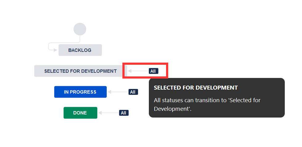

Hello @Vineet Sawhney ,
It looks like the following configuration has been made in the workflow:
“Select Allow all statuses to transition to this one in the properties panel for the transition.”
Add a global transition that allows every other status in the workflow to transition to the selected status.
https://confluence.atlassian.com/adminjiracloud/working-with-workflows-776636540.html
The visible things on these board are status, transition is the path to/fro status
the reason why it is showing 2 in one column & 3 in other column because of number of status mapped to respective column
so when you drop the ticket in either of column's options then status will change to the same
