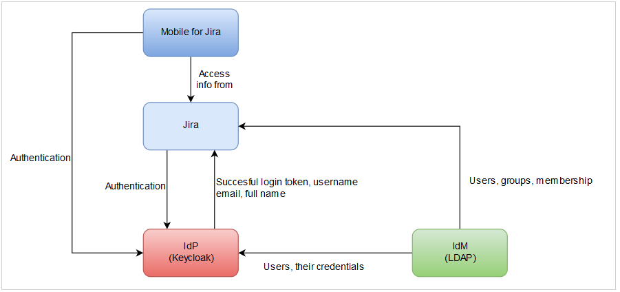

I haven't been able to find any informations about this particular questions. I have done synchronizations itself with AD numerous of times, but now I am struggling a bit with this scenario:
Authentization in our network is done against IdP called Keycloak. We use Kerberos and we can force 2FA over Keycloak to certain users (as thats why we use it). Keycloak itself is federating users from LDAP and all things connected to users (groups, membership) is done directly in LDAP. Keycloak is also federating some other users from other systems, thats again why we use it.
Now I am struggling with Jira itself. When I autheticate against Keycloak, all I get is information about that given user (e.g. about his roles, his credentials etc.). But these roles must exists already in Jira as groups. Same applies to users themselves (as I don't want the users to be created automatically, if they don't exist, partially because user is authenticated everytime, even shouldn't have access to Jira). How can I get all the groups inside Jira, when Keycloak is unable to work as LDAP itself (or maybe I am missing something?)
What we want to achieve:
What we did now is that we added synchronization directly with LDAP (which help us achieve request number 2. and 3.) and authentication is done trough one of the SAML SSO plugins available on marketplace.
We struggle now, that user is able to login directly to Jira, because all his credentials are now in Jira. We are able to redirect automatically to Keycloak login, but then the are other places, where he can still login directly into Jira (e.g. app Mobile for Jira).
Rather that making a hack solution not to store passwords in Jira or not authenticating against LDAP, I want to achieve proper clean way to these three points. I am unsure that synchronizing LDAP to both Keycloak and Jira is needed, but I don't see any other solution how can I manage groups in LDAP.
Does anybody came across similiar problem, or maybe I am just misunderstanding the whole problem at all.
Actual status is drawn here:

Hello @Christian Reichert _resolution_,
we want to prohibit users for using directly LDAP, because the whole company uses Keycloak as main place to log in (it is already combined with Kerberos, 2FA etc.) and we wanted to maintain same route for all apps we have in our network (not all of them Atlassian, most of them are not). Now we are in state where we are managing users and groups in LDAP along with the membership. Users are then federated in Keycloak along with some few other users from different systems (lets say some external workers dont need LDAP account, because its sometimes easir to handle it different way). Now we want to connect to Keycloak and make every user authentificate trough Keycloak, which is already in use and people are used to it.
Now we need to "add" Jira to this whole process. Requirements are that managing groups, people and membership stays in LDAP and login stays trough Keycloak because of the Kerberos, 2FA etc.
I am rather talking about whether our thinking is right or wrong with connecting Jira to LDAP to get users/groups/memberships and connecting it to Keycloak for authenticating users. :-)
Have a nice day!

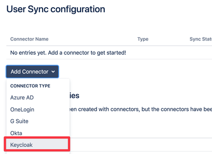

Hey @cr ,
thanks for pointing that out. I am happy there finally is a solution to get federated users and groups from Keycloack a sync them into Atlassian applications. I will have it in my mind for all new implementations we are doing for our customers, sadly this one already went different way without your awesome plugin (topic is already over 1 year old).
Could you please copy/paste your post as a new one to this thread so I can accept it?
Thanks!
