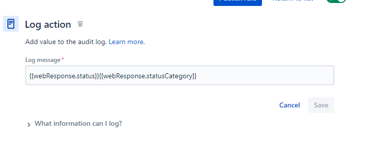

Step 1: Even if your Send Web Request is empty, it is possible to collect the sending log of this request through the jira log action. For that, you need to check this box in the Action of "Send Web Request":
Step 2:
After the "Action" of the Send Web Request you will add a new Action called "Log Action" and this log action will include the following variables: {{webResponse.status}}{{webResponse.statusCategory}}
Just copy and paste :)
Response.status = Success code (200 if ok)
Response.statusCategory = Status Category (Success, error, etc)

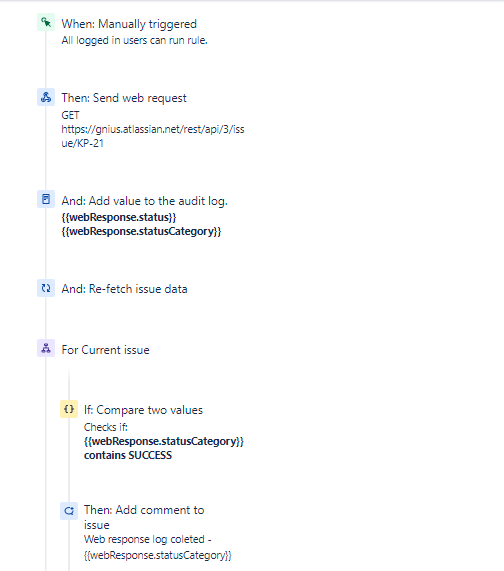

Step 3: After the Log Action, I added a new action in the automation called "Re-fetch". This is like a Jira base refresh and particularly I just used it to ensure that when jira starts reading the statusCategory condition, it will find value in the log.
Step 4:
After the re-fetch open a BRANCH for the Current Issue (or the target issue you want).
Inside this branch, you will add a condition like "Advanced compare condition" and put the following configuration in it:
Step 5:
After performing the comparison condition, still inside the BRANCH, add the final Action of your rule. What do you really want to do if the web response result is successful (transition issue, edit issue, comment issue, etc).

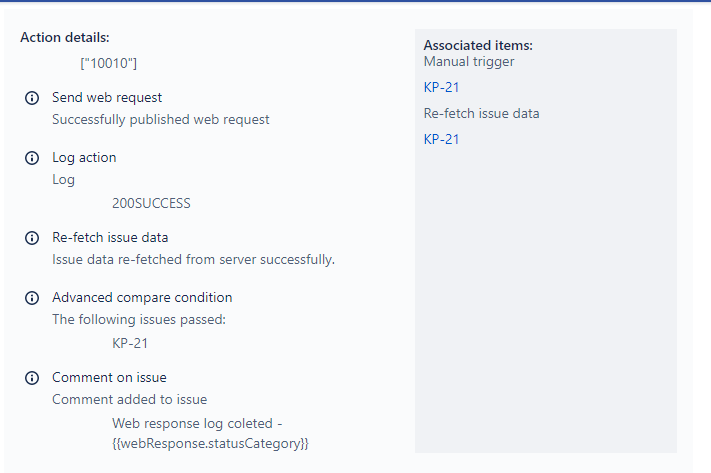

In my case I put a comment issue and it worked perfectly in this logic. See the complete log of my automation:
Forgive me if I forgot something, but it's important to know that you can turn the result of your web request into a condition using this logic, so from there you can build a better automation that will do what you need.

That is my complete automarion rule:
