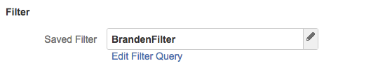

I'm unsure why your saved queries wouldn't show up, however, when you copy an existing board the filter will be the same. To change the filter:
Once that is complete, change the query to the new query you saved and you'll be set with the new query:
