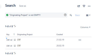

That's my search results just looking at the latest tickets created in that project. (for CRF-41 the value was typed in manually by me)

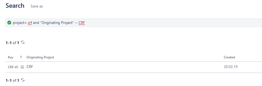

That's my search results looking for the specific value: (same results for using "CRF" instead)
